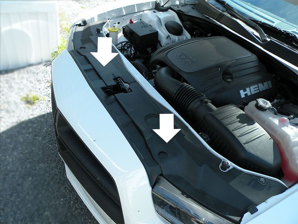

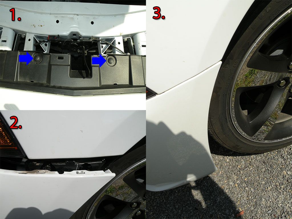

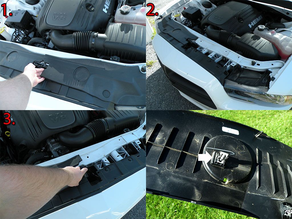

Step 1: Remove the front covers
Fig. 1: Start with the Driver’s side first, the plastic is flexible and you can easily lift the corner at the center of the car. Pull up on the cover starting at the corner and working your way around to release the clips. It should come pretty easily.
Fig. 2 Driver’s side removed
Fig. 3 Repeat the process from figure one and remove the passenger side cover. The white arrow indicates the aforementioned clips in figure 1

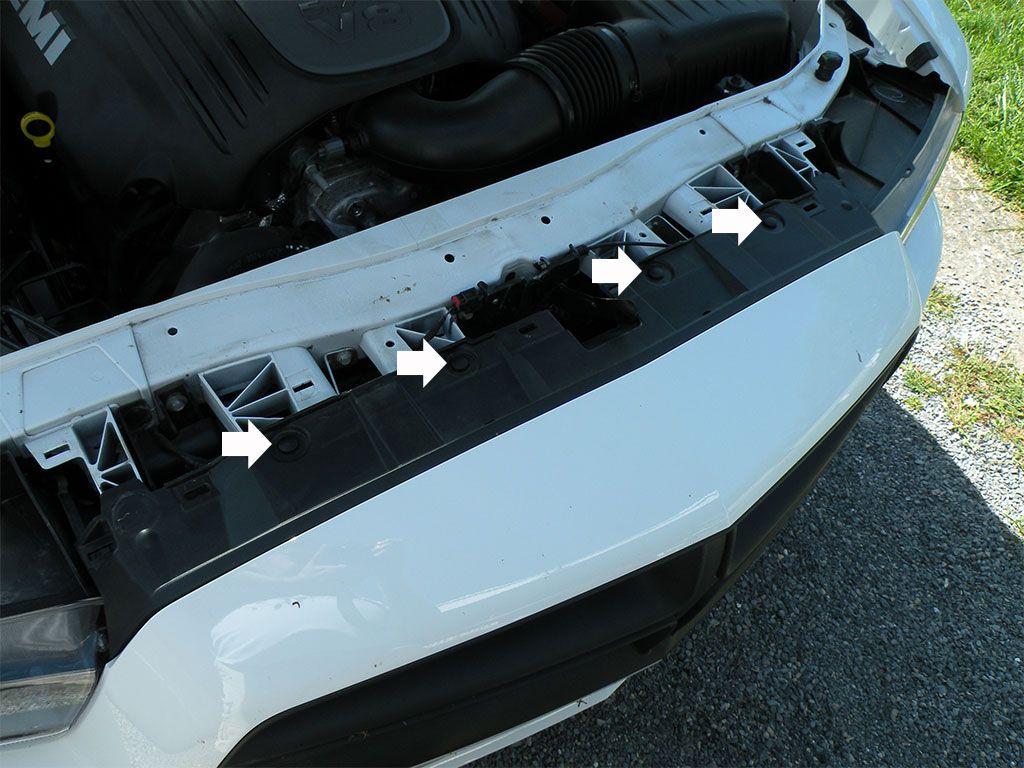

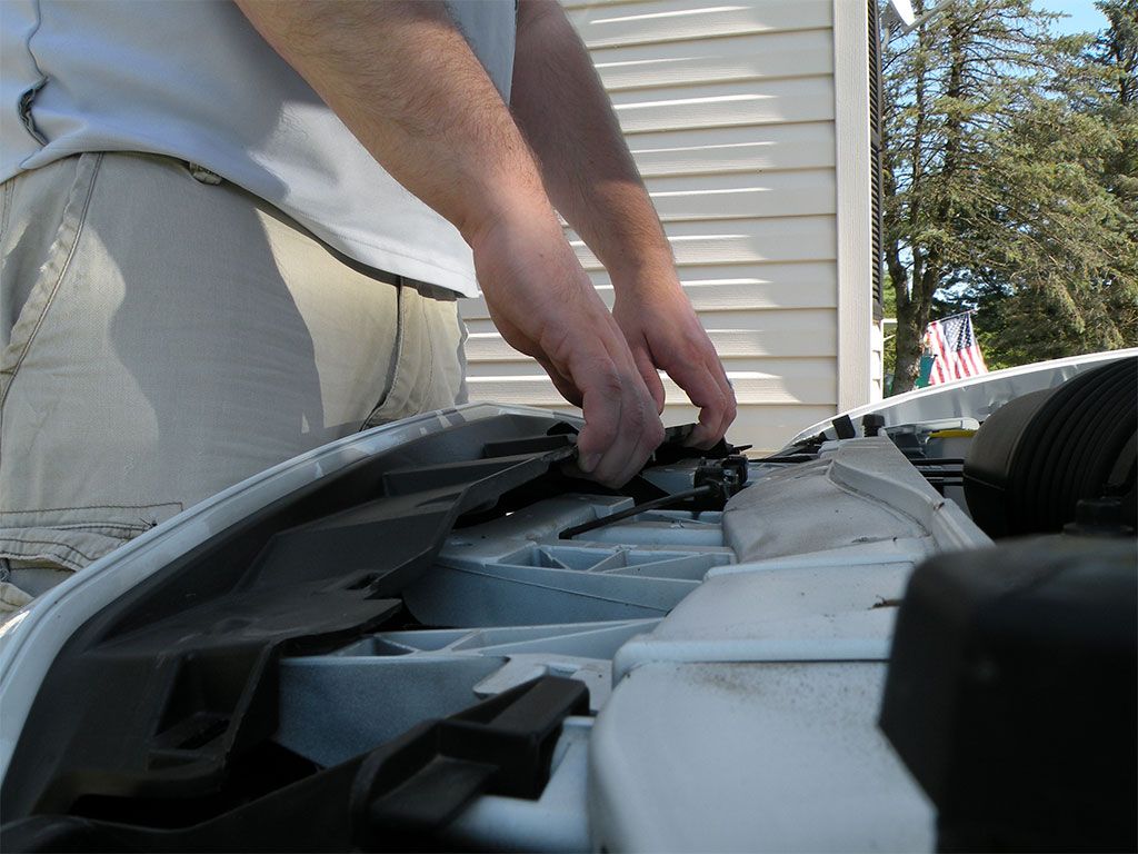

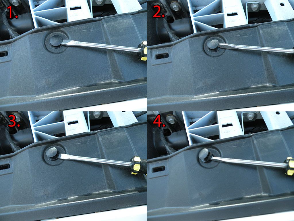

Step 2: Remove the push-pins that hold the top of the bumper in place.
Fig. 1 Slide the tip of your flat-head screwdriver under the top section of the push-pin. If you look carefully you will find a slot for your screwdriver to slide into.
Fig. 2: Slide the screwdriver all the way in to the center and twist, this should start to pop the center of the pin up, continue this process around the top until the center pin is all the way up.
Fig. 3: After the center pin is up, slide you screwdriver under the bottom section.
Fig. 4: Repeat the process from figure 2 to remove the pin completely. Then repeat the process from figures 1-4 to remove the other three pins. Be sure to put the pins somewhere you will not lose them.

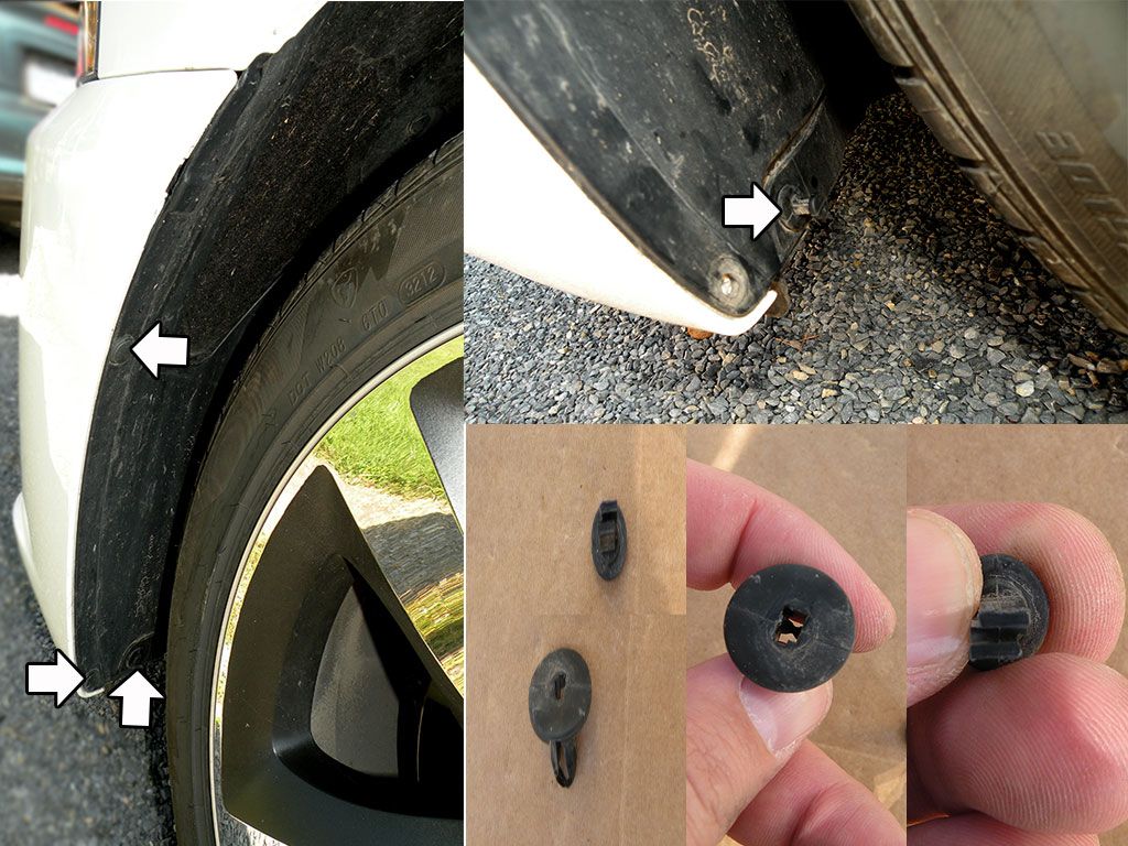

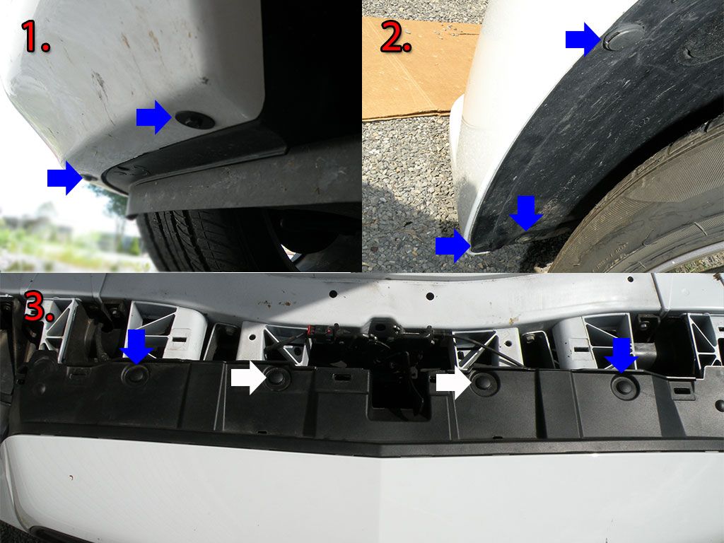

Step 3: Remove the push-pins on the inner fender
On both sides of the bumper there are 3 pins you will need to remove. For this, you will use the same process from Step 2. You will notice that the pin on the inside looks different but they work the same way. Do not be alarmed if these pins come apart, but they only go back together one way as you can see from the picture.

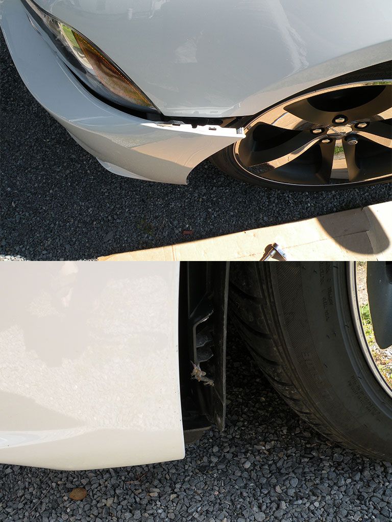

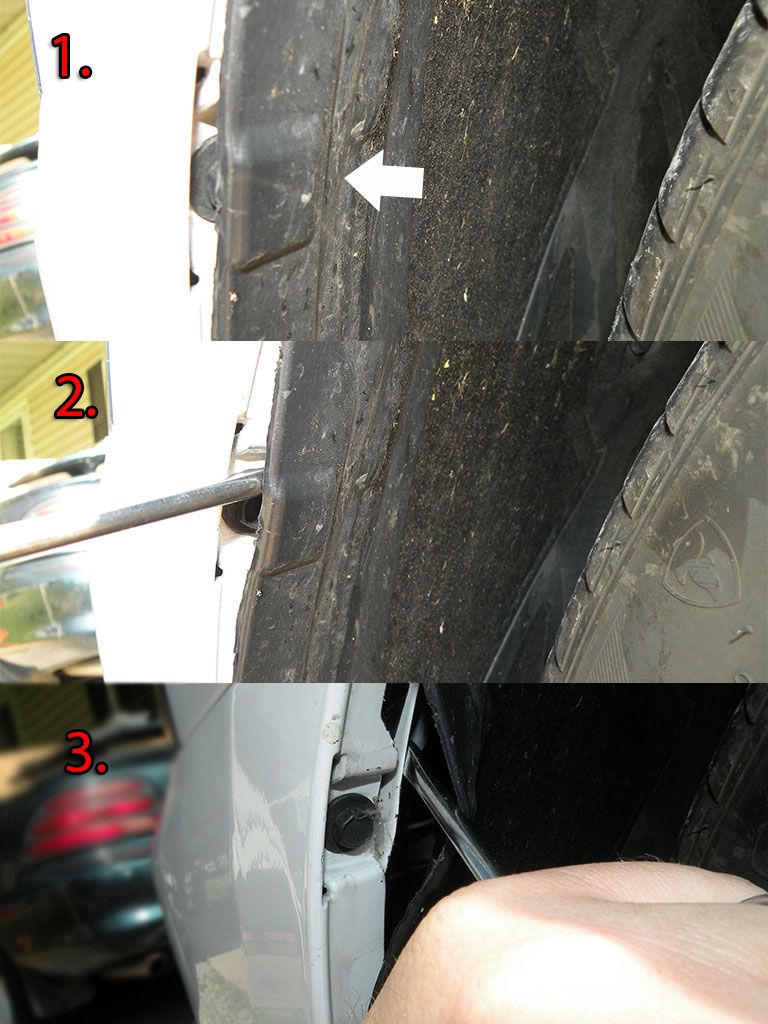

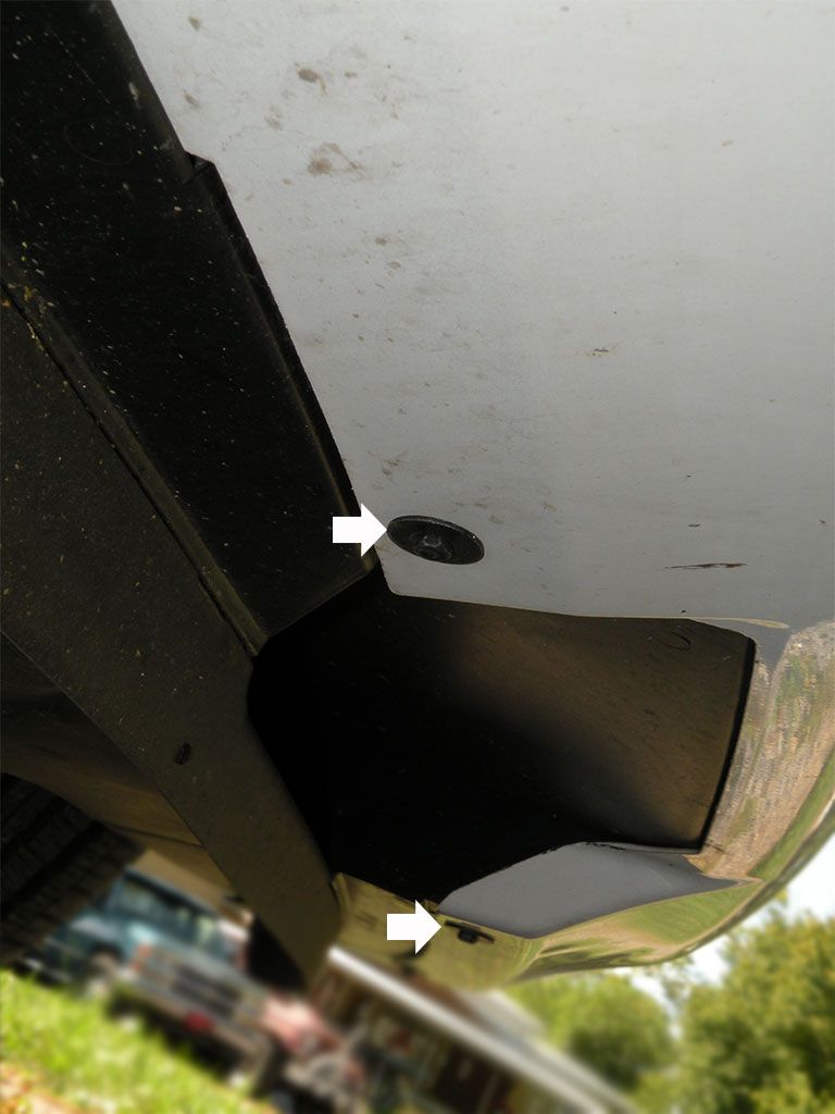

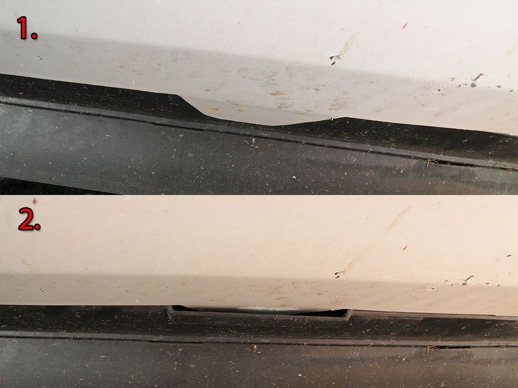

Step 4: Finding and exposing the bumper bracket screw
Fig. 1: Look for the raised spot on your inner fender (indicated by the white arrow), about 2 inches below the fender/bumper seam.
Fig. 2: Slide your screwdriver in between the plastic inner fender and the edge of the bumper. Be gentle so you do not damage your paint.
Fig. 3: Make sure you’ve slid the screwdriver in far enough that you can us the metal of the fender to pry against and pry the plastic inner fender away exposing the 10mm screw.

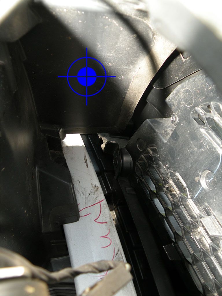

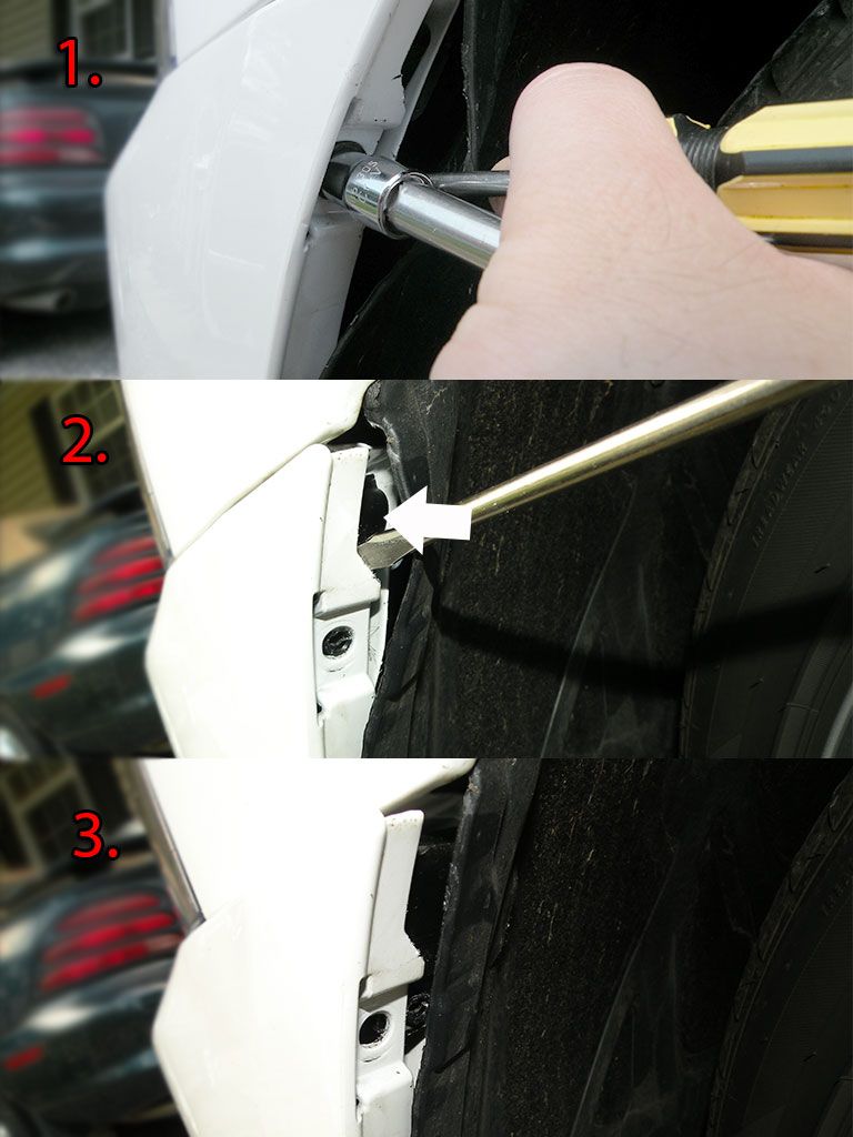

Step 5: Remove the Bumper Screw and pull the bumper away from the body
Fig. 1: While holding the inner fender back with you screwdriver, remove the 10 mm screw with your wrench or socket. (This is one of those places where and extra hand would be useful.)
Fig. 2: While still holding the inner fender away for you to see, slide your screwdriver into the notch indicated by the white arrow. Make sure it is between the bumper and the black plastic bracket underneath. Then pry the bumper away from the bracket.
Fig: 3: It may seem hard to pry the bumper away from the bracket if this is your first time removing it, but it will come and it should look like the picture in figure 3.

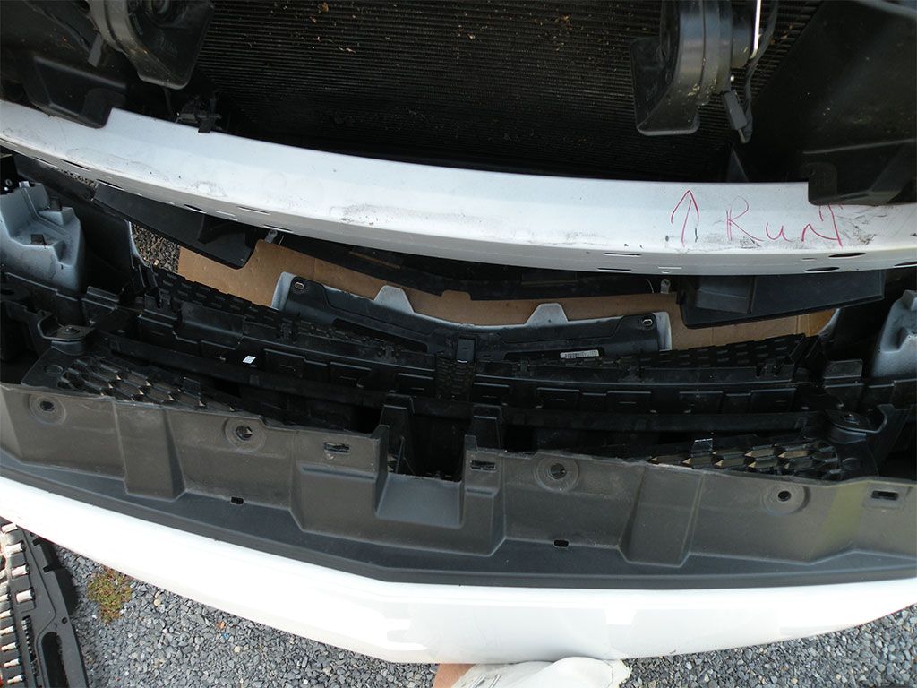

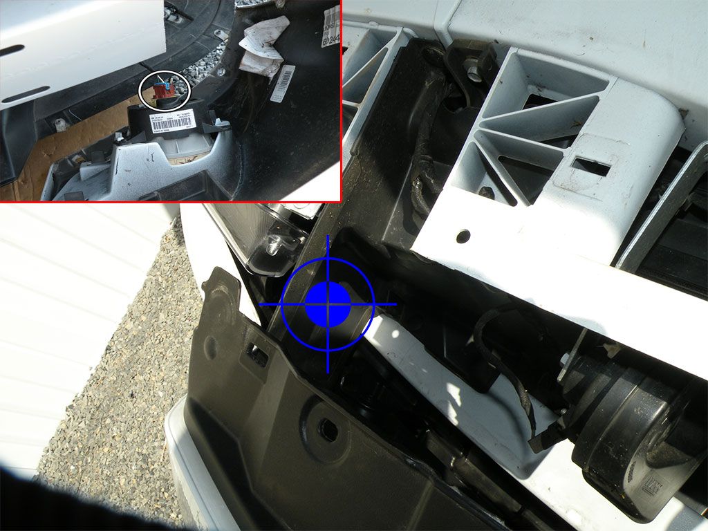

Step 7: Removing the bumper (make sure both sides are free of the bumper brackets on the fenders)
I have found that it’s easiest to grab the bumper in the top center (as shown in the picture) and lift up slightly and pull the bumper toward you. I keep it close to my body so I do not drop it. Pull it just far enough that you know it is completely free of the vehicle and you can set it down on you blanket or in my case the cardboard.

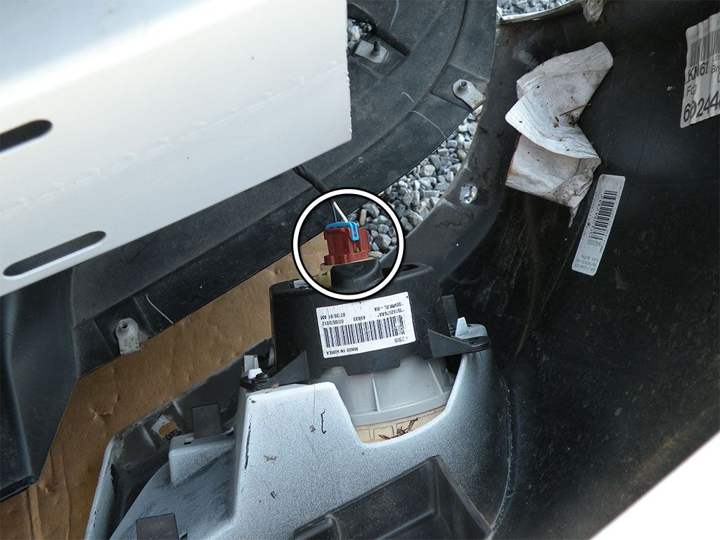

Step 8: Unplug your fog lights if you have them.
TADA! Bumper removed!

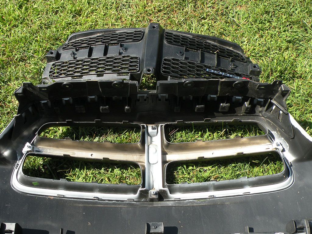

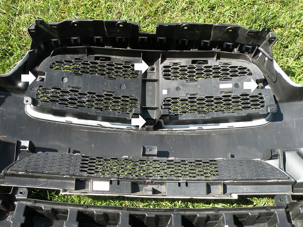

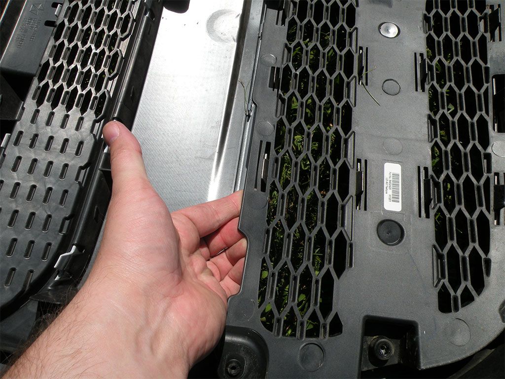

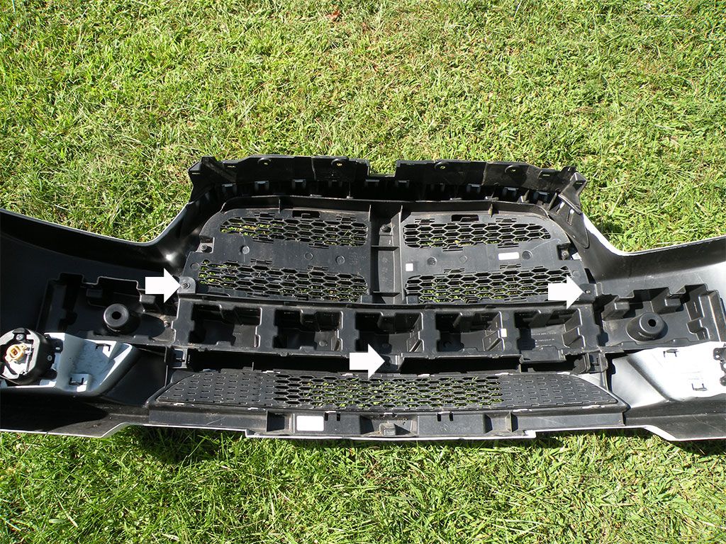

Step 9: Remove the Inner Bumper (lay the bumper face down on your blanket or I chose my yard)
In order to remove the inner bumper, remove the 3 Phillip’s head screw and lift away from the bumper.

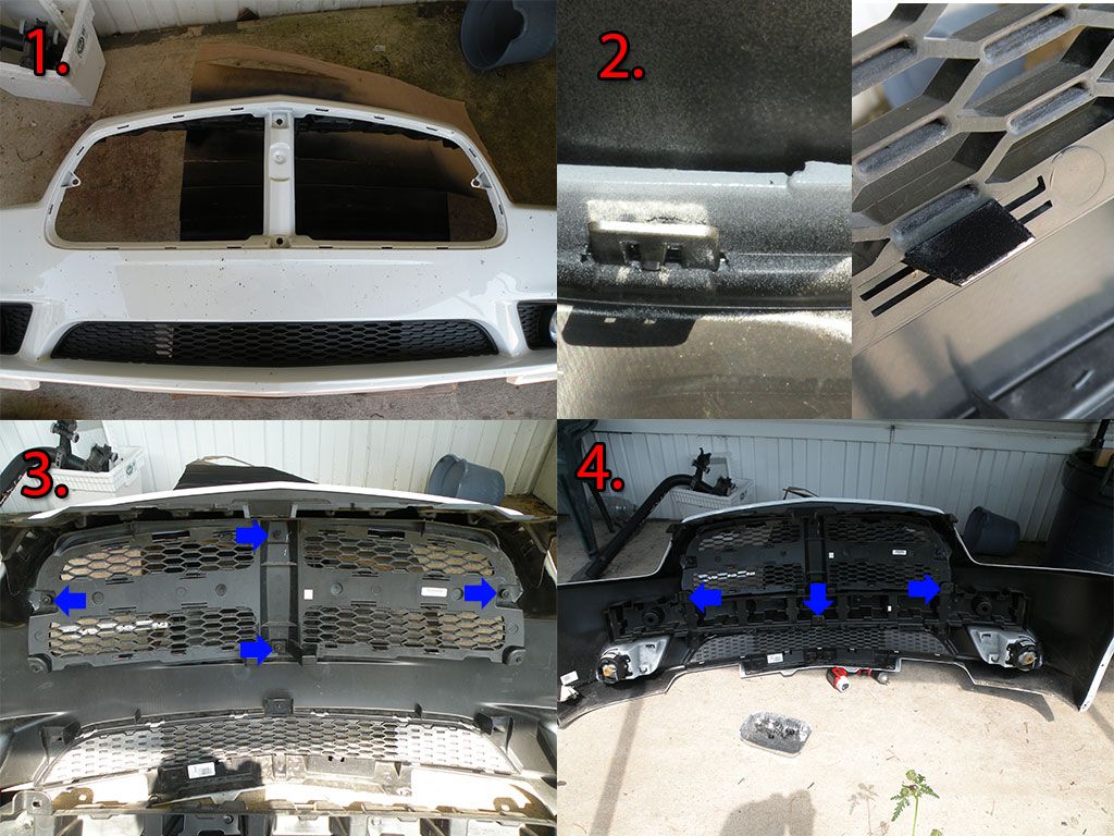

Step 10: Remove the Grille Honeycomb
First remove the 4 Phillip’s Head screws indicated by the white arrows.

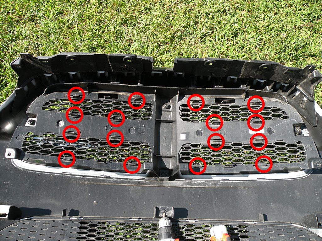

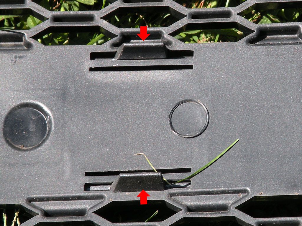

Next (one of the “fun parts”) is the clips that hold the honeycomb in place. These are indicated by the red circles, 16 total.
You’ll need you push these clips in and then down (or pull up on the honeycomb) to release the honeycomb from the grille surround.
Since I was doing this alone, I found it easier to start at a corner and carefully work my way around. This part can be challenging, so be sure you do not break clips.
When you’re done it’ll look something like this

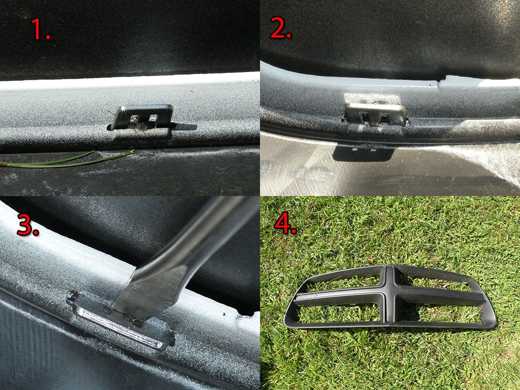

Step 10: Removal of the Grille Surround
Figures 1 & 2 Show a close up of the clips that hold the grille surround in place. In figure 2 you can see the part of the clip that you need to press to make it release.
Fig. 3: Use your screwdriver to push in on the center of the clip until it passes the point where it holds, then push it down through the hole to release it completely. You may have to use your screwdriver on the back side of the clip as well to free it from the bumper. Repeat this process all the way around the grille surround until all of the clips are free, 16 total. I found it easier to start at a corner and work my way around. This can be tricky if you’re doing this by yourself because these clips tend to pop back in if you are not careful. Also, be sure not to break these clips off in the process.

Step 11: Bumper reassembly; Grille Surround, Honeycomb and Inner Bumper
Fig. 1: Place your bumper face up (I have mine on a small table) and press your grille surround back into place making sure all of the clips line up with the holes in the bumper.
Fig. 2: Make sure all 16 of the Grille Surround clips are seated back into the bumper and locked in, then snap the honeycomb back in place from the back of the bumper. Be sure all 16 of the honeycomb clips are seated and locked in place. You will know when the clips are seated and locked because they will make a pop sound.
Fig. 3: Replace the 4 Phillip’s Head screws (blue arrows) that hold the Honeycomb in place.

Fig. 3: Replace the remaining push-pins in the top of the bumper near the engine bay (indicated by the blue arrows).

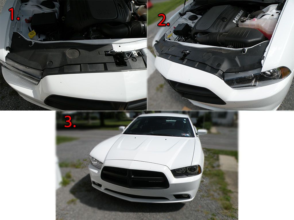

Step 16: Replace the covers
Fig. 1: Replace the passenger side cover first.
Fig. 2: Then replace the driver’s side cover.
Fig. 3: Close the hood and reconnect your battery if you chose to disconnect it. Clean up and call it a day!

Fig. 2: Replace the push-pins on the inner fenders and do not forget to put the odd one on the bottom inside. Don’t forget to do this on both sides of the car
