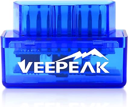

I bought this one. Actually, I bought two as there are occasional reports of them not working. Both of mine work. They were a "favorite" in a Ford diesel truck forum at the time. I bought them to work with TorquePro on a Samsung tablet.
