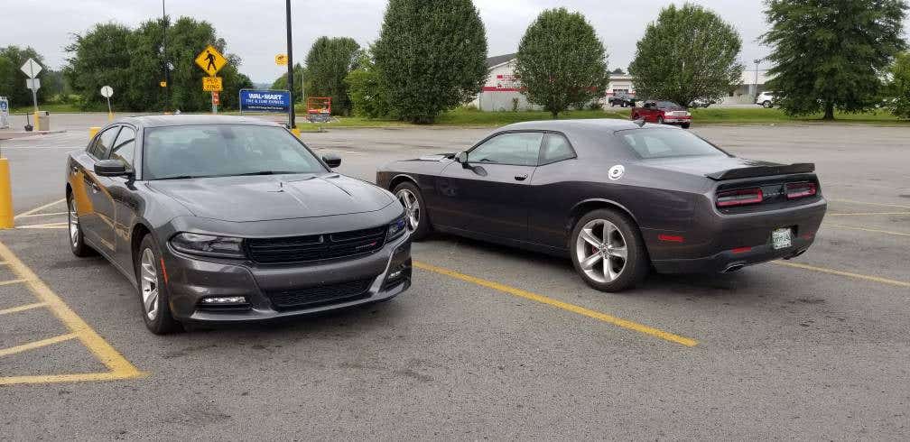

So my fiance has the sxt charger.. nothing special. But side by side with my challenger we noticed her charger is ALOT slower than the challenger (which is also the 3.6 sxt)
We went online and found her car at 295hp and the challenger at 305... I don't see that really being a HUGE difference.. so we swapped cars. I drove the charger and her the challenger.. of course the chally has sport mode.. but again the chally came out ahead.
Does anyone know the actual wheel horsepower of the cars? And maybe where to get a little more horsepower?
I know we prolly should have gotten the V8s, but in all reality our credit wasn't that great and we wanted these cars.. so here we are...
