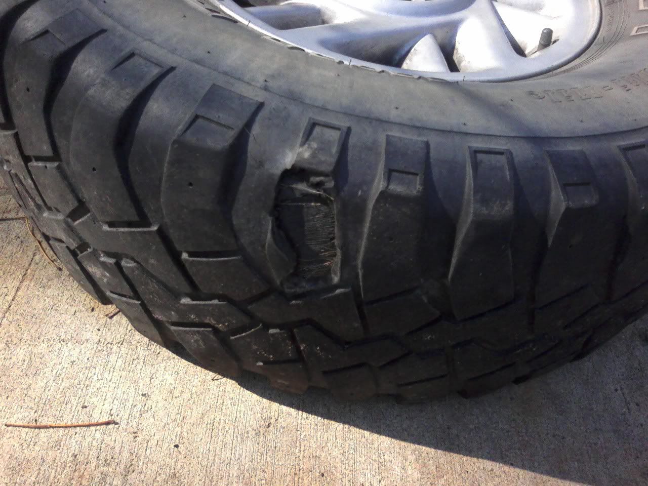

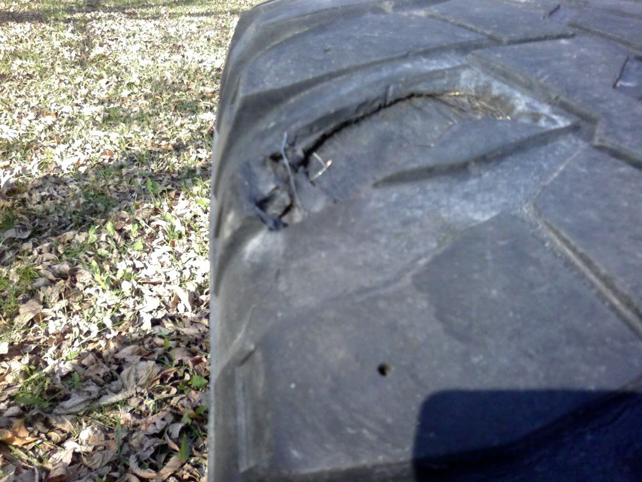

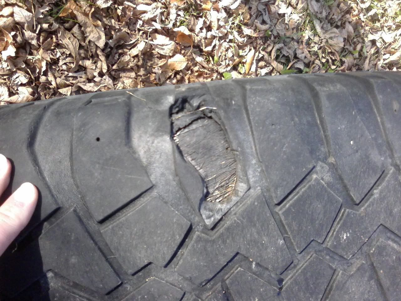

The otherday I drove my Dakota to work because the weather was kinda bad and I noticed the tire vibration had gotten a little worse. I've had all 4 tires rebalanced about a halfdozen times and about 5 people other than I have looked at the tires and some how this got by every one of us.
That tire only has 12K miles on it, but the vibration has been there for about 3K. It looks like a clear case of tread seperation (like the Firestone tires from a few years back) and there were a couple small spots that looked like it was going to happen in other areas. The other 3 tires are just fine.
The part that kicks me is NO ONE stocks a 32x11.500 R15 tire, it'll be Tuesday before I can get one ordered in. Oh, and the 15 year old spare tire that has NEVER been used looks in about as good shape as the one with the tread seperation (the rim itself looks/feels like its going to crumble, its visible in the last pic).... :dead:

Wow..I have seen worse. 1st stop spinning your tires. You should be able to get 30K out of a tread like that. Also its not tread separation. The tire would look much more distorted. You are what it looks like at about 2/32nds in tread which all manufactures state they have no control over a tire which is at or below the legal limit. If you look at one side of your lug you will notice that the lug has been sliced. You either caught a rock or something metal that started to cut the lug open. That would not be a warrantied tire. Anyhow, glad you caught it!! Because of your driving you may need to do more frequent tire checks.

The tires have 12K on them and the other 3 look almost new - there is a defect with this one. There were small areas that look like they were bulging and ready to do break open like the spot pictured. You can't really see it, but the steel belts were poking thru the outter part of the tire, where the tire still had a lot of rubber left.
