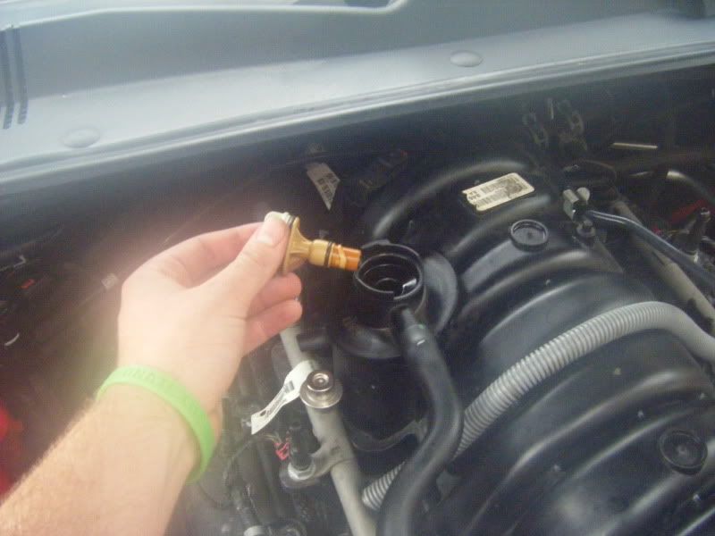

So i was helpin my buddy change his oil in his 07 RT. We started the car back up and there was this annoying tap/rattle. We isolated it to this:
Not sure what it is never messed with one of these chargers before looks like a filter of some sort of recirc for the intake, had gas and oil smell to it. So looking at it theres a metal piece inside this white plug that goes into the canister on the intake. WTF is it, and the noise goes away when u remove the cap and comes back when u put it back on. So im sure is the metal piece inside the white cap.

That's the PCV. If it's rattling that means it's still good.

Well thats retarded why would something rattle if its working fine. Besides it is rattling obnoxiously loud you can here it inside the car. and it didnt do it before. Theres a crankcase vent tube right under the oil filler cap that goes to the intake hose/box. Dont see the purpose of this thing built into the intake and has a tube going from it back to the intake that doesnt make sense for a pcv

Yep thats the PCV. Usually you dont hear it when the engine cover is on and the hood is down. Hell - its probably the reason they use the engine cover in the first place.

ok thanks for the replies, ****ty design i guess?

I had the same problem. I read in the service manual that it should be cleaned and then oil both seals and put it back in. I did this and haven't had a problem since. Not sure if it will work for you. I don't think this should be making noise. But, it could be a chitty design.

I think we'll clean it up real good and oil the seals thats worth a shot.

That's strange, when I bought my car in January it was rattling and thought it was broken, so the I sent it to the dealership to fix and they replaced it and now it's dead quiet.

That is weird the little metal piece inside the cap looks like its only there to vibrate when air is flowing by, thus making it a tell. But it was never this loud before. Might just put a rubber plug in it or something to fix if cleaning it doesn't help.
