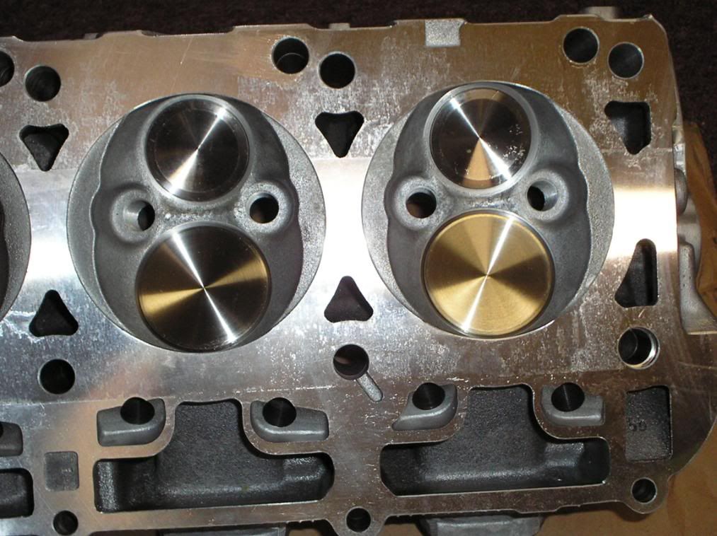

Well here we go I finally decided to dive all the way in in one shot. Just started my install on my PPP stage 2 heads, PPP Track warior cam, Jba Headers, HHP Jba cats, 6.1 injectors and I'm gona control it all with a Diablo tune. I started the install on Saturday and so far I have about 8 hours into it. I have about 70% of the job done and hope to be finished within the next day or so. Unfortunately I got lazy with the camera and havent taken too many pictures durring the actual install. I'll get more pics as I progress and maby even some video when It's back on the road. Before the install I got some base Dyno #s as 306RWHP and 340RWTQ. I can't wait to get it back on the road and on the dyno again, too bad I have to work to pay for all my new toys otherwise I could dedicate more time to get it all done now.

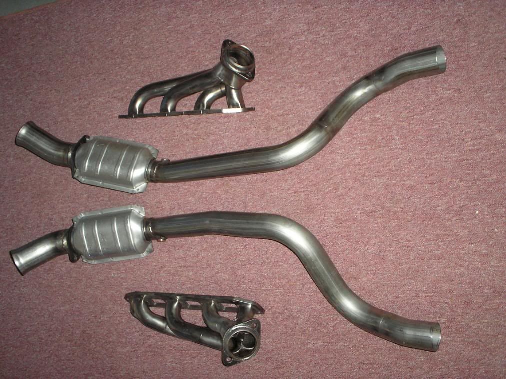

JBA headers and HHP jba cats

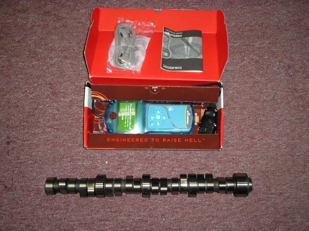

Diablosport predator and PPP Track warior cam

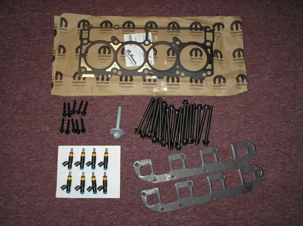

Mopar Head gaskets, Head bolts, crank bolt, 6.1 srt injectors

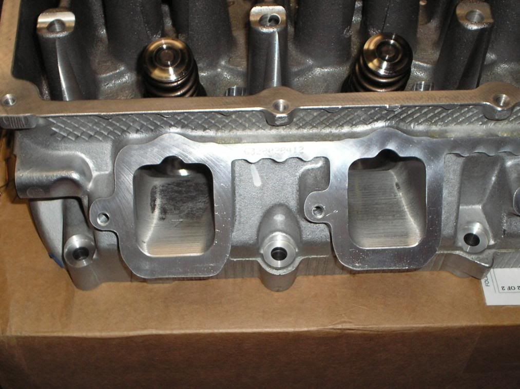

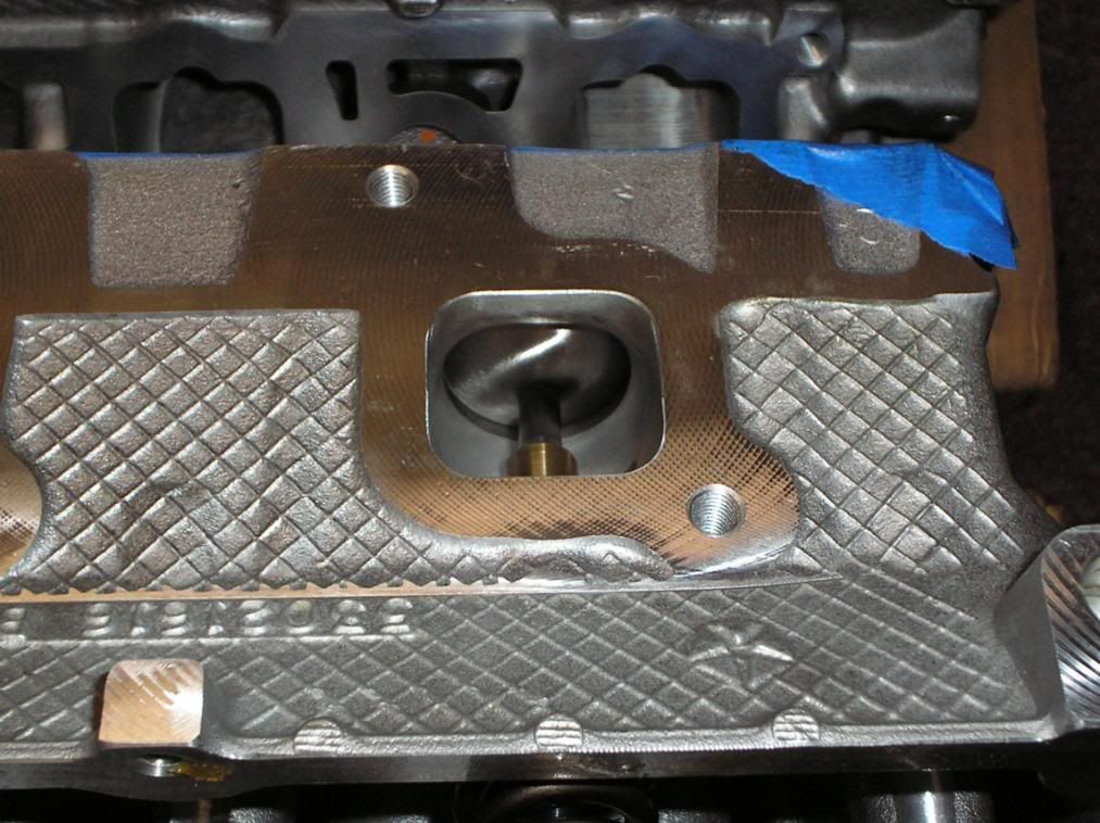

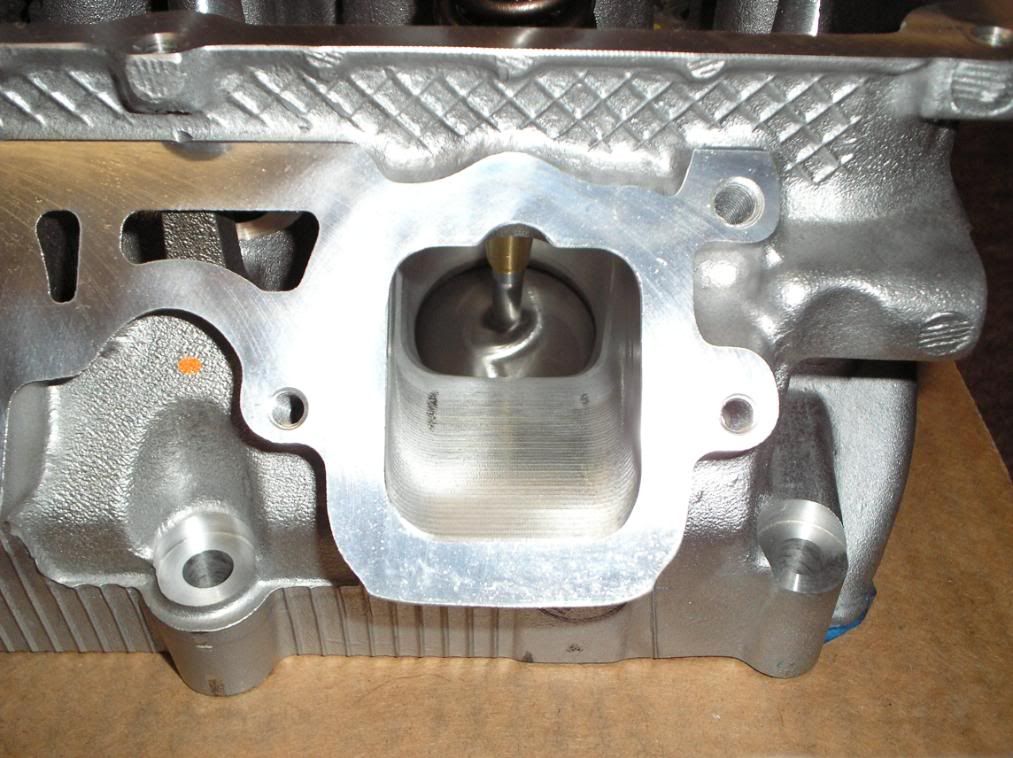

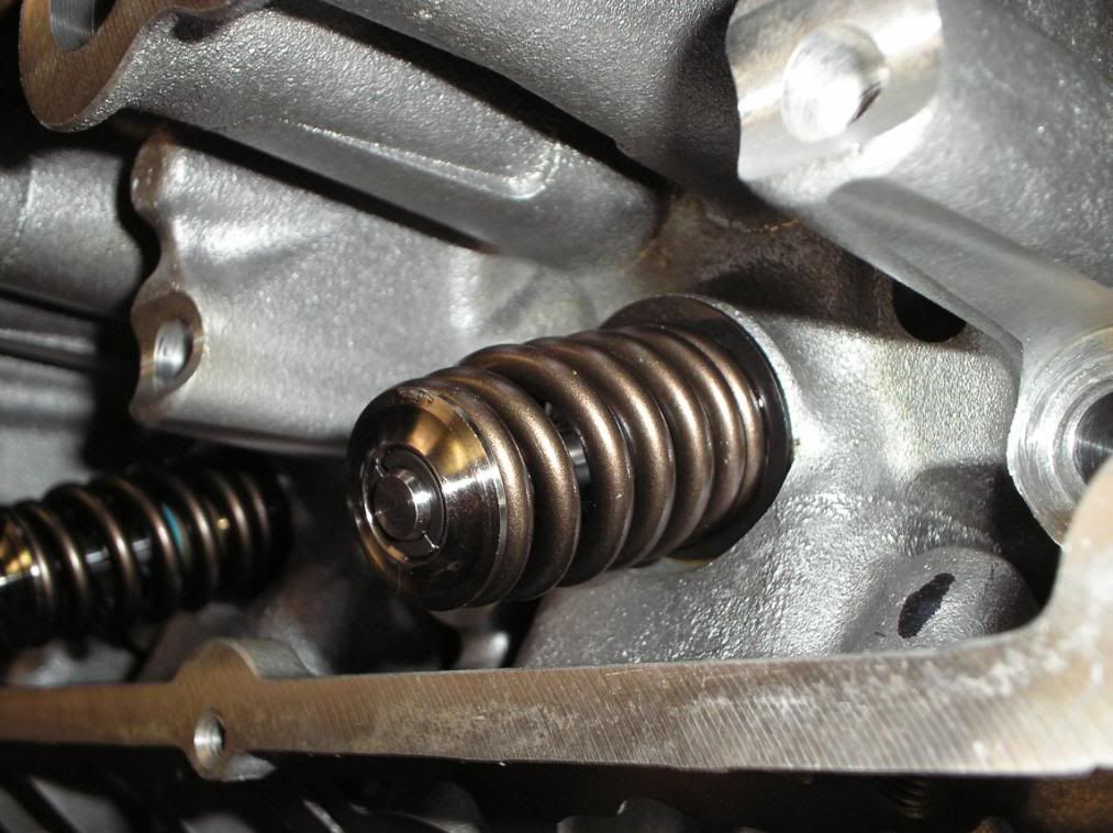

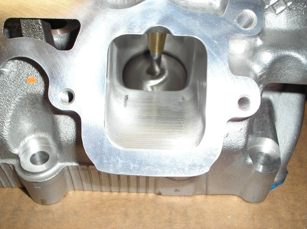

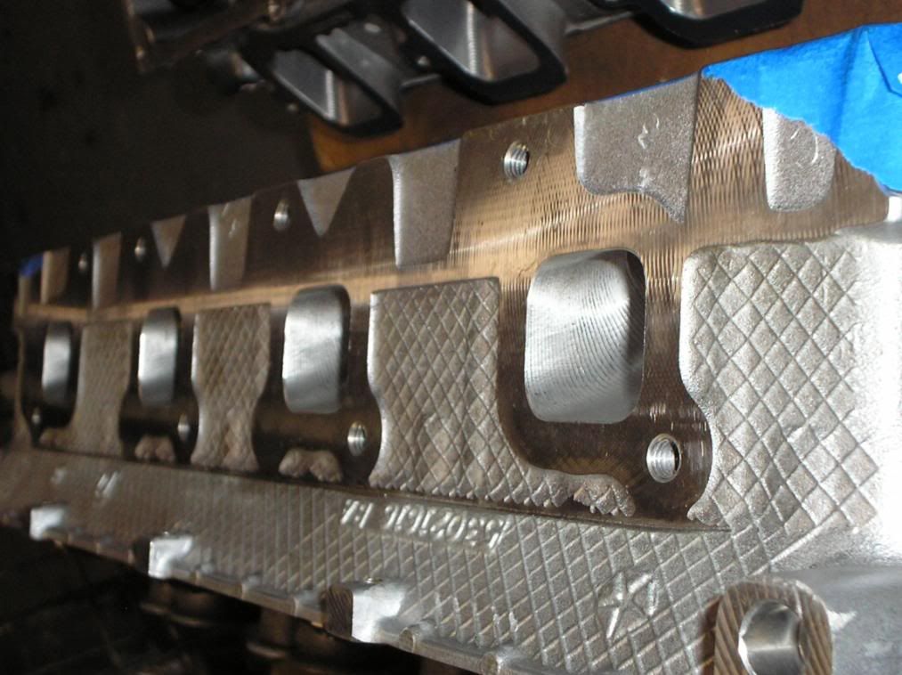

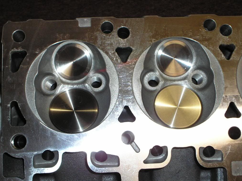

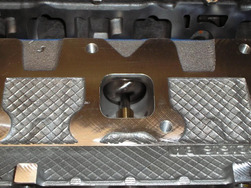

Power Ported Performance 5.7L Stage 2 Heads
Let The Fun Begin
Man, I am soooooooooooooooooo jealous. Guess ya dont like those heads huh.......

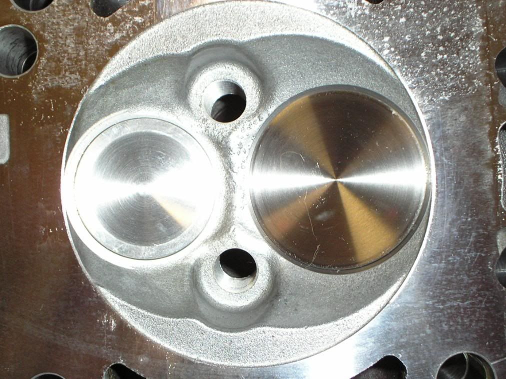

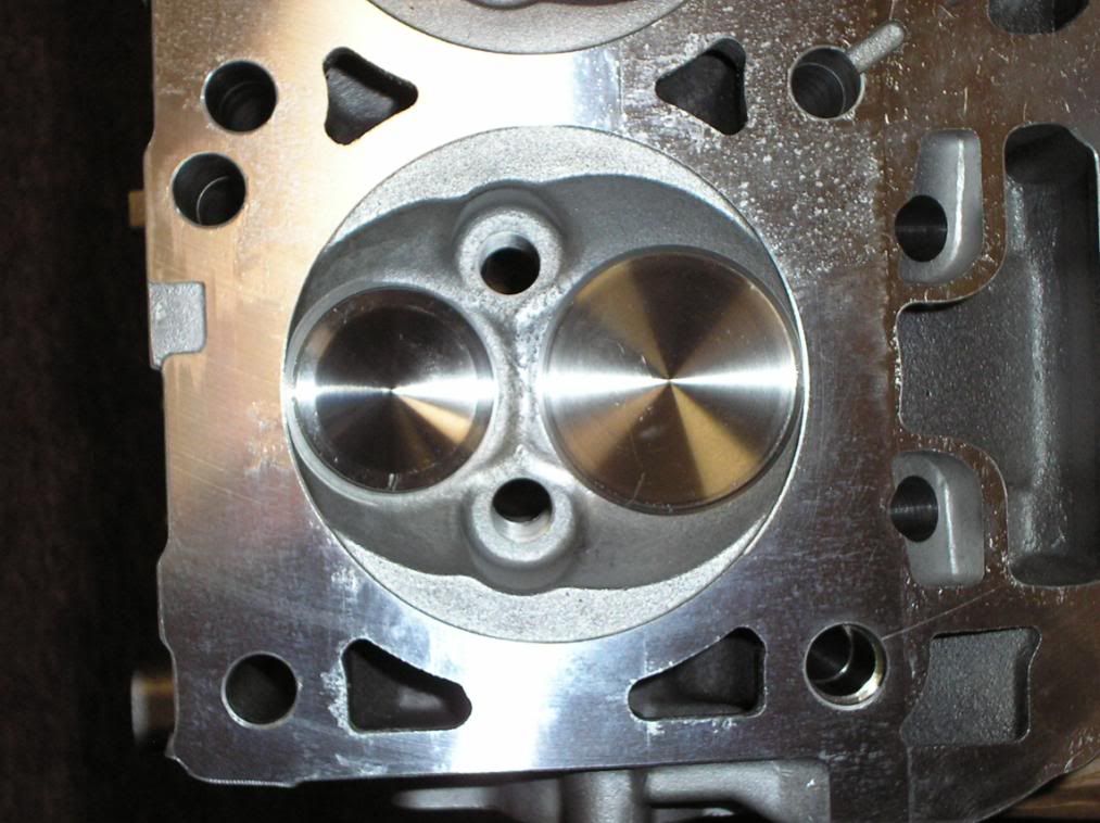

By the way, whats the deal with a few of those valves? Are they not NEW valves?

They are all bran spanking new! Just too excided taking the pictures that I didn't take the time to wipe the lint off of them, thier all as shinny as a new silver dollars.

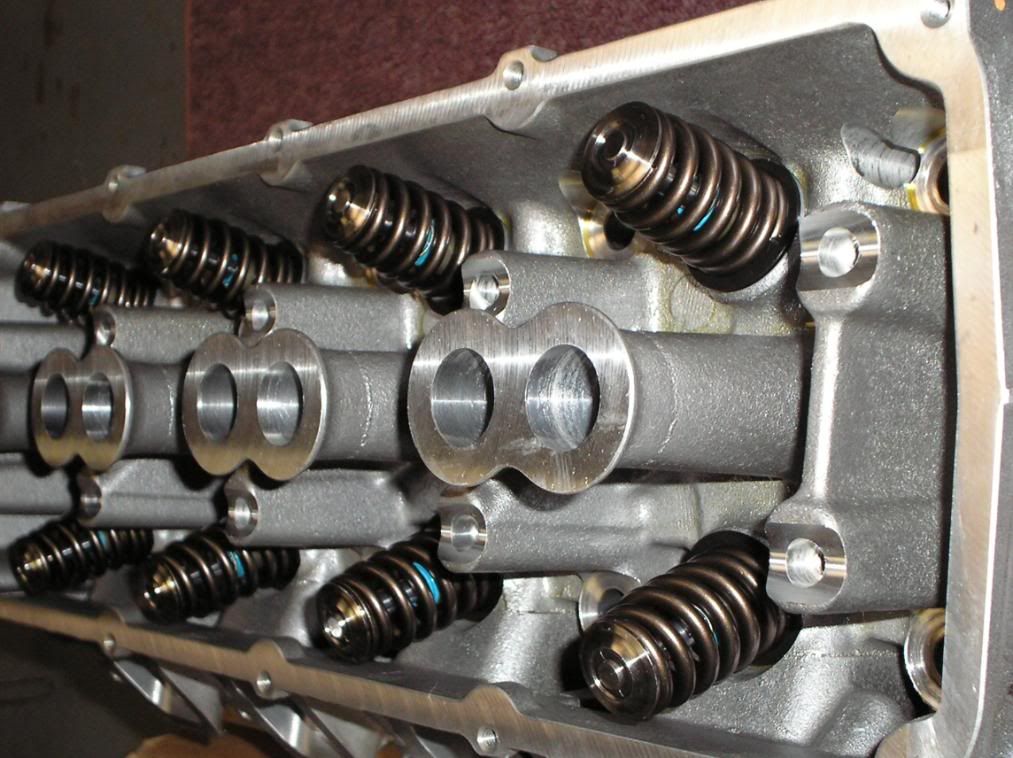

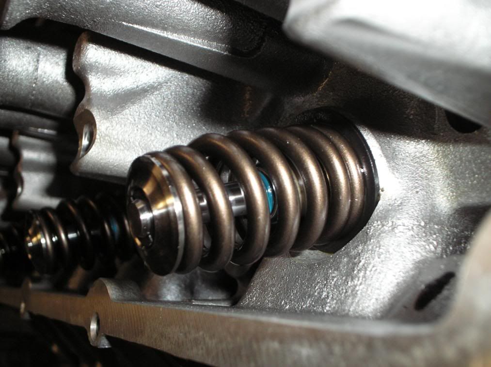

Here is some of the info on the Heads.
Stage 2 5.7
Valve Job Radius exhaust/4 angle seat
of intake/2 angle valve job
Milled Y
Locator Hardened
Valve Spring 221428-16
Valve Seal viton
Locks Machined
Retainer Titanium
Valve Guides Bronze
Valves 2.02/1.57
Misc. Clean and assemble
PSI Valve Spring available
2.055/1.60 valves available
2.08/1.60 valves available
From Power Ported Performance
