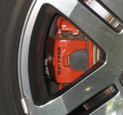

So I'm finally posting pics of my brake job. I used Duplicolor spray engine enamel and it seems to have worked really well. Chrysler Orange for the base, and then clear over the base and decals. The decals are from Vinz Decals. I know you don't have to take the calipers off for this, but I did to make sure I got good coverage and no overspray onto other parts. One of the best mods I have done to date!

Danni - Go ahead, that's what the forums are for. No worries about being beaten up here. :lol:
NavySEAL - I was thinking about doing black calipers as well, and then put orange decals on. I personally wanted more color to show through, but that would look good as well. I also want to get dark gunmetal/black rims at some point, so I thought black would just get lost.

that looks great!! i didnt know there was an orange out there that matched the mango's so well. and i agree w/ what u said, black would look good but they wouldnt stand out like orange, or any other color. looks like u did a great job! how long did it take you? i painted mine last weekend and it took a whole day cause i had to kept getting distracted.
84 Posts
It took about a day for me as well. I was also working with just the spare jack. I didn't have anything else handy to prop up the car. I had done a really poor job of painting before, so some of that was prep time getting the old paint off and prepping the surface to be painted again.

On the thin piece of the caliper where the brake pad is did you remove the brake pad to paint and was it as easy as removing the top piece?
84 Posts
I'm guessing you mean the part closest to the center of the wheel. This piece is directly connected to the hub with two bolts (18mm, I believe). Just by taking these two bolts out, you can slide the entire caliper off of the rotor (both pieces).
I removed the pads and the metal clips that hold them in place and taped off the sensitive areas, so I could paint freely around the caliper without worrying about getting stray paint on something I didn't want it on. I didn't seperate the pieces before painting. They were painted assembled.

These are my calipers on my Sublime. I didn't do the bracket. Should have I think. Still like it. Nice job by the way.

I've actually had a few friends say I should have done it this way. The high performance brakes like the SRT8 Brembo's don't have this lower arm and by not painting it, it gets lost in the wheel and the caliper looks like a high performance one. While I do like that look better, I wanted as much color to come through as possible, so both parts got painted.
