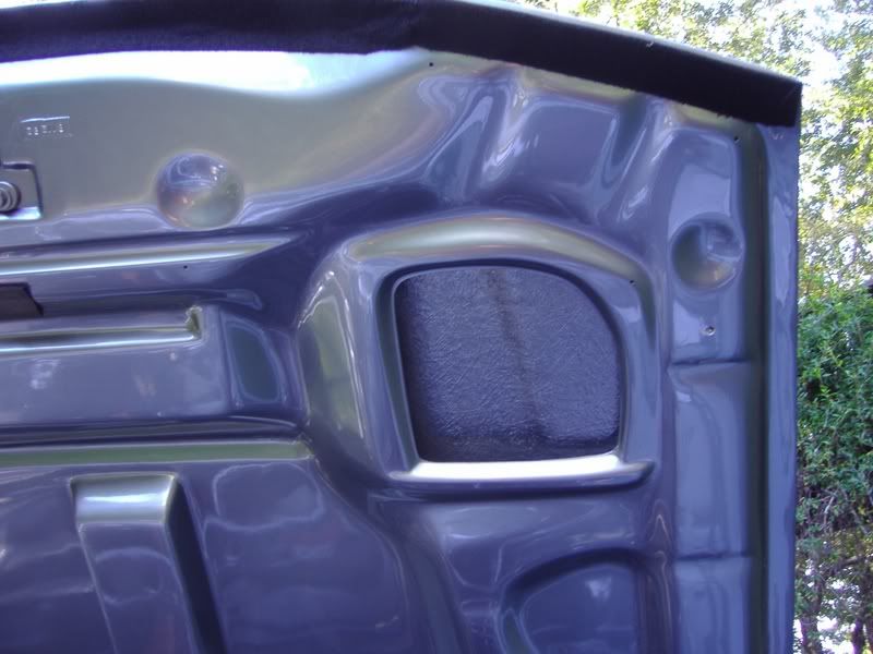

The one offered by the hood company is made to go with the stock intake plumbing only. Who uses that! I decided to make my own to fit almost any aftermarket CAI. I added a few extras like an adjustable damper that draws extra air from the stock location, the 4" hole down below. Opening this damper also allows use of a cover for added protection durring a hard rain.
