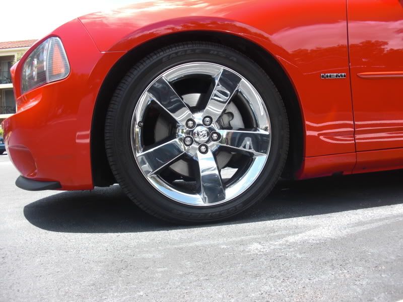

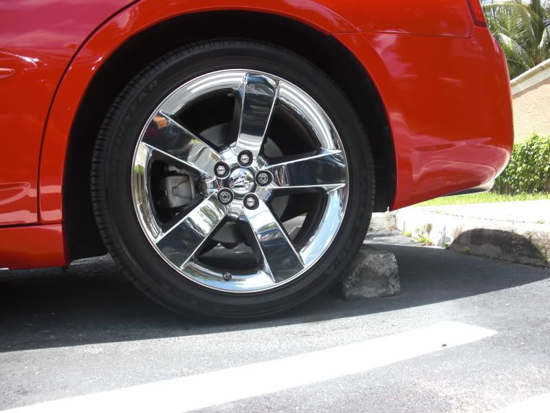

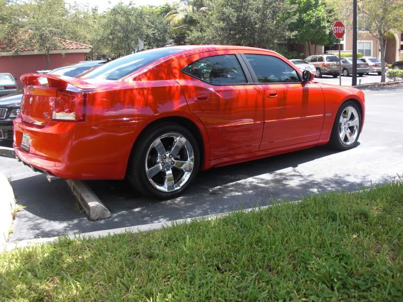

Well here are the pics. Install has about 15 miles on it so I guess they'll settle a little more. I was able to notice the front drop instantly. However the rear not so much yet. I know with the pro kit the rear is supposed to be a little higher which I am cool with. Anyways here she it..
It looks real good brother....wait till they set in a lil then it will drop a lil bit more then you'll really notice btw did i say it looks reallly good:D

Crappy pic I just took but it's confirmed I have nivomats :(
9,859 Posts
The self leveling wont let them drop....

Here is a look front and back dropped
