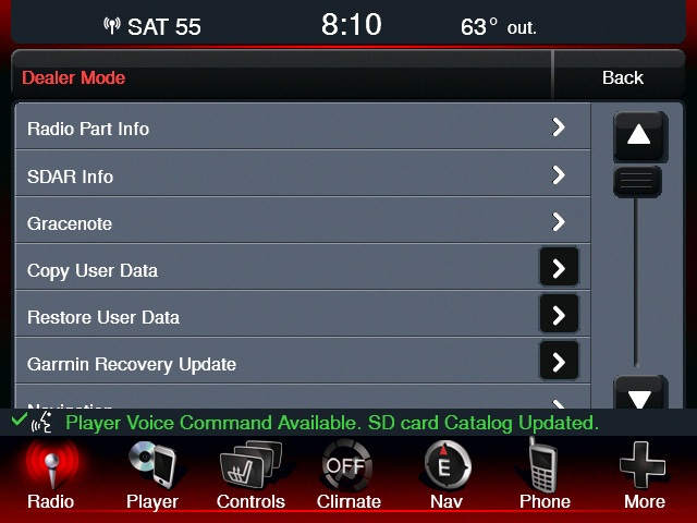

You should now see the following screen:
Before you start the downgrade, you will want to back up your user data.
Select "COPY USER DATA" and follow the instructions. It should ask you to insert your clean usb.
Once it finishes copying the user data, you can now begin the downgrade!

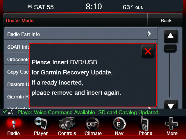

Click on the arrow next to "GARMIN RECOVERY UPDATE" and you will see this pop up:
Go ahead and insert your flash drive that has the CTP13 firmware on it and follow the instructions!

Thanks! I'm having trouble downgrading ctp16 to 13. I put it in dealer mode copied to user date then the update. It finished but when I hit restore data I get an error message user data restore failed. No user data in the usb
