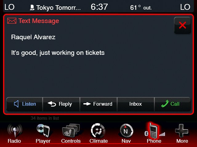

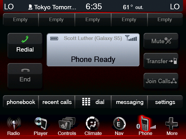

So, I do not know EXACTLY what fixed it, but in short, I backed up all of my data and did a restore on my phone!
After that, I went in and let it do all of the downloads and updates!
When I went to pair my phone, it asked me to have access to messaging, which it never did the first time!

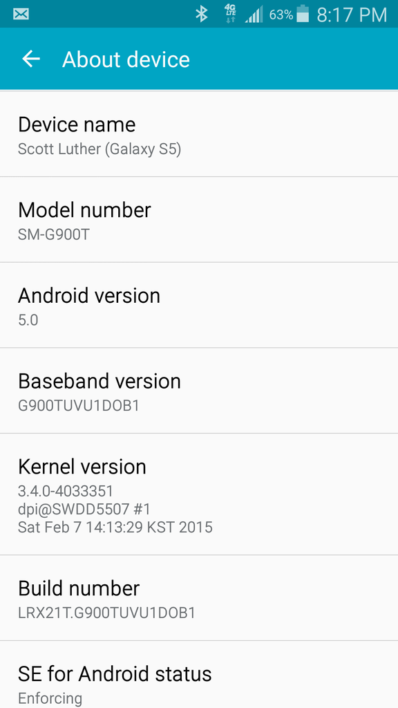

I have also been able to get messaging working on my S5. I thought I'd share my observations.
I picked up my S5 on Tuesday. Like others, messaging wasn't working on Uconnect radio. So I looked here and found this thread. I was hopeful thati could figure it out since others said they were successful. But everything I tried didn't work.
That night the phone prompted for a software update. I hoped that would fix it. It didn't. However, on Wednesday the phone prompted for a second update. That update was an android update. The phone was updated from 4.4.4 to 5.0.
I hoped again that the update would fix the messaging issue. I got in the car to test and the messaging button still wasn't available. I was frustrated to say the least. So I thought I'd try re-pairing the phone to the radio. I deleted my phone from the device list on the radio and unpaired the radio from my phone. Well, when pairing this time, there was a new prompt for accessing messaging. Said yes and I'm good to go. Messaging is working finally. Woohoo!
So it appears that Google corrected this issue in the 5.0 version of the OS. The key, though, is to delete your phone from the radio and the radio from your phone after the update so that you can re-pair and get the new messaging prompt.
Hope this helps.
