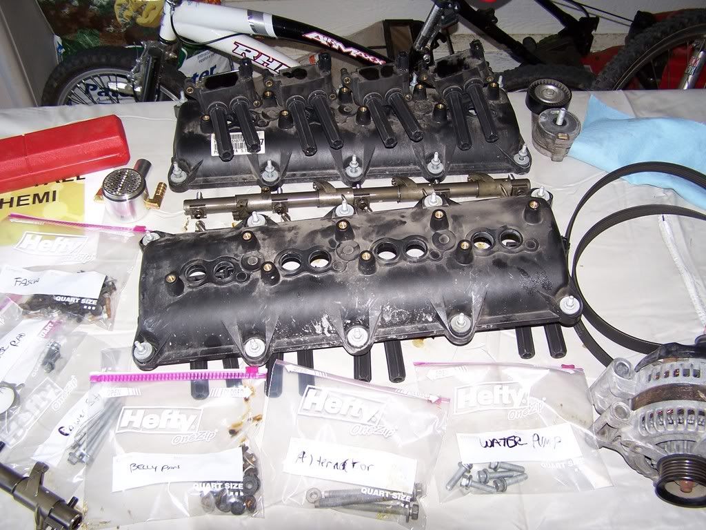

Somebody suggested using Ziploc bags to keep all the bolts labeled and organized during the tear down. I'd STRONGLY recommend this to everyone. We didn't have any 'leftover' parts afterwards:
