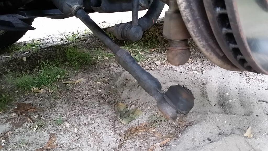

I have a 2007 Dodge Charger R/T Daytona. It just hit 80,000 miles. With very little warning (it made noise 2 weeks ago). I drove to get dinner last night, and when I made a right the whole car wobbled and I felt the car lurch. I picked up dinner and by the time I was driving home the car again wobbled and I lost control. I slowed down to a crawl and was able to get in to the grocery store parking lot. My husband met me there. He drove the car home very slowly and when he pulled in to the driveway the drivers side tie rod end popped out and the wheel turned in.
My question is HOW can this happen to a car that is 7 years old and taken care of, especially with very little warning.
Thankfully we picked up the parts over the weekend to replace it this coming weekend.
I'm also so grateful that it happened when it did. I was on vacation and due to go back to work today. I can only imagine what could have happened had I been driving on the highway at 65-70mph :( ugh
**** Update including a picture of my tie rod end, real nice!! ****

The front ends are notoriously weak on these cars.
Yours is not the first to have this happen.
The front ends also have a "clunk" that never seems to go away.
It's easy to replace, make sure they replace both sides!
Mine went around 60k but I didn't let it get as far as you did.
The front suspension is supposed to be inspected every so often for maintenance.

I just had the car go through inspection in January. It's strange cause only 2 weeks ago I heard a noise and then it went away. Last week it started again, we bought the parts and was going to replace it this weekend. 3 mechanics didn't detect it.
I've been reading and now know this is an issue.
Both sides are being replaced today. Drivers side is done, next passenger.
Thanks everyone!!

You need to find another mechanic(s). Tie rod inspection is something anyone can do. If your mechanic can't perform this simplest of inspections you really need to find another mechanic.
8,140 Posts
To keep this from happening you need to get rid of the sealed for life parts. Once you upgrade to greasable ball joints and tie rods you will have little to no issues as long as you keep them greased
