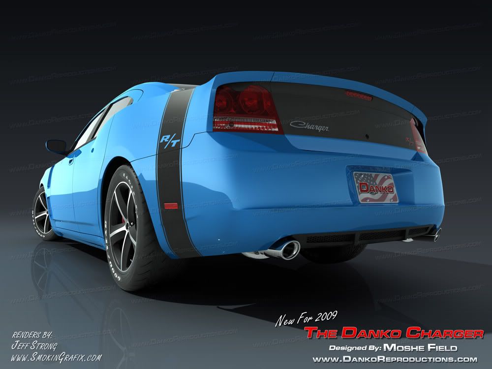

Now that I'm finished with the front fender moulds, I'm kicking around once again the idea of making a rear widebody as seen in the 2009 danko charger renders, but I was thinking now that people would want it wider than the stock rear quarters unlike my original plan of just making the top part fatter. If I was to do this, how much wider should I make the rear? seems to me like it should be between 1" to 2" wider to hold some fatter meats on the back. I want it to be possible to use between 10" - 12" rims. On most rims, doesn't the extra width of the rim get split and 1/2 goes in and the other 1/2 comes out ?
Mo, I would suspect that a 2inch width increase would be the way to go if you would like to offer it to those wanting to do 12" rims. As far as the width increase in rims, if the backspacing stays the same then the additional width goes out not in, thus requiring a 2 inch width increase in the body as opposed to a one inch. Of course, I would go with a 2 inch increase over a one but someone else might tell you that a 1" is sufficient! Depends on how you like a look and depends on how low you go with lowering springs/coilovers/airride. :bigthumb:

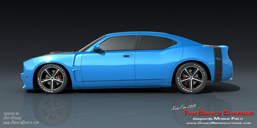

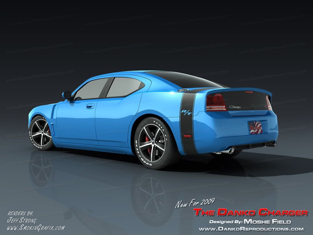

Here is a quick photoshop of around a 2" widebody compared to the first version. Wouldn't look that much different from the side, but the tires would be much fatter and the direct front and read view would be much more aggressive.
Nice! :bigthumb:

Mo, looks awesome! I can't wait to see what you do and how you do it. To answer your question on wheel width. The wider you go, the wider the outer lip and not the inner hoop. The inner is set on a max width, which is 6"+ or so. I'm running 22X10.5, 3 pc forged, 6" inner hoop and 4 1/2" outer hoop. So if you add 2", I'll change my outer hoop to 6 1/2".
So if the fender is an add on, you would have to cut some of the original fender to allow clearance for the wider wheels, or else it will rub.

Here is what is in store for the rear, I'm already working on it!
