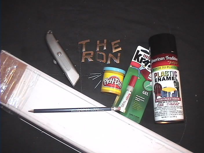

Materials needed for this mod, if you call it that, included the following:
PlayDoh - .99 cents
Badgemyride Automobile Letters - 14.00 shipped (for letters "THERON")
Screw and Bolt set from Home depot -.98 cents
Plastic Enamel Black Spray Paint - 4.97
Crazy Glue - 1.97
I already had some tools that I barely use (A house warming gift). For this project I used a jigsaw, powerdrill, and sander.
Now the hardest thing to find for this mod was a piece of plastic. I couldn't find a plastic warehouse in my neighborhood. A flat black plastic ruler would have been perfect, but I couldn't find one. Go figure! Luckily I bought some blinds recently and kept the box realizing that it may come down to using that for this mod. It is the white box looking thing in the picture above.

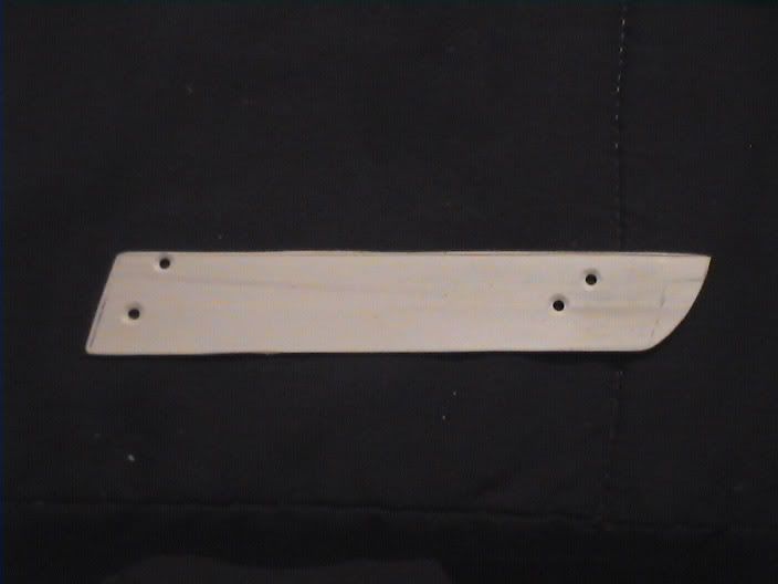

To get started, of course, I laid the letters on the plastic and traced them. Then I cut the pattern out of the plastic and used the sander to smooth the edges for a "product look." LOL!
Unfortunately, I do not have pictures for this next REALLY NEAT step that I thought of. After the plastic was cut, I pressed it on some PlayDoh and stripped the excess off with a razor. When I pressed the plastic and PlayDoh on the Daytona Grill, it left an imprint in the clay. This allowed me to asses desired location and know exactly where to drill the holes for the screws. I picked spots that would hug the grill really well and assure a horizontal display.

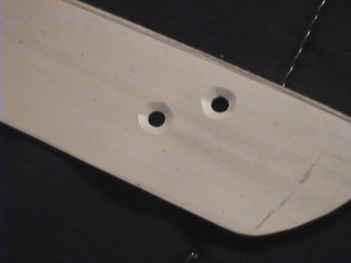

Then I drilled holes in the plastic in areas that would also avoid the letters. I also took a larger drill and scraped the surface of the plastic as to create a rivet so the screw could lay as flat as possible.
The next steps called for (1) painting the plastic black, (2) painting the screws black, and (3) eventually sticking the letters on the plastic cutout.
I then created a duplicate plastic plate and painted that. This was used as a backing that I could use on the inside of the grill. The screws go through the custom plate, pass throught the grill, and then passes throught the duplicate plastic cutout, and there they meet the bolt. This allowed me to tighten the badge really well.

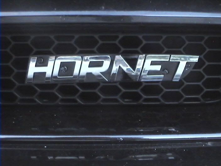

The final product looks like this:
Here is a picture of it up close and personal. You can see the screws in this picture.
Any comments or thought would be appreciated. I am just glad I finally got this done. It has pre-occupied the back of my mind ever since I placed the order for the automobile letters.
If I could do it again:
1 - I would probably wait a few days to touch the painted plastics before installing. It felt wet, but was for the most part pretty dry after sitting overnight. However, on the spot right between the "E" and "T" I created a blemish in the paint when I tightened the screw bolt to make it tight. I do not think it can be seen in the pic, but I know it is there....and that is all that really matters.
