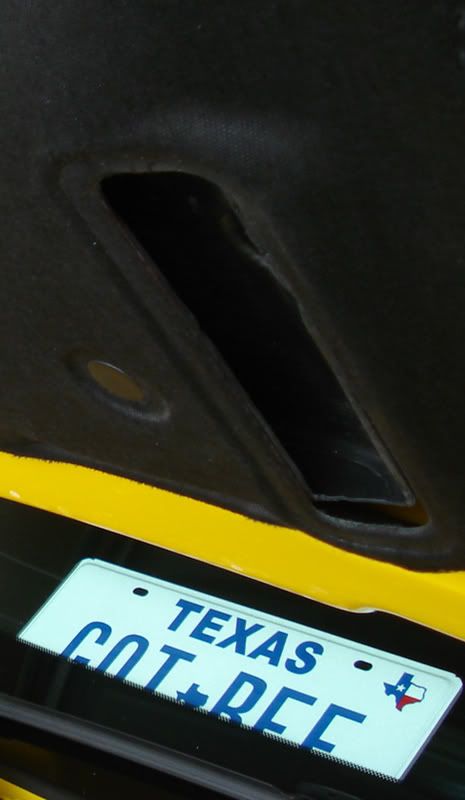

Before I removed the hood liner and the plastic hood intake. I pushed up on the hood liner, near each intake hole. Then took a red sharpie pen and traced my cut line for the plastic intake. Then I removed the hood liner and plastic intake. I used a dremel tool to cut a starter line on the trace line. Then I used a utility knife to cut along the starter line. Then finished it off with some light sanding.
Passenger side.
Driver side.
Hood liner and plastic intake re-installed. Now the hood liner is the lowest part of the underside of the hood. The plastic intake has been trimmed back behind each hole, in the hood liner.

OK I trimmed the intake scoops and I went to close the hood and it felt like it was hitting. So we grabbed a light and its still hitting but it will close. So I wasn't feeling comfortable with it hitting it or touching while it was closed so I decided to take the bar out. We trimmed off the scoops until they were flush with the lowest part of the intake scoop and it still hits and would be rubbing constantly while closed. It looks like its actually bulging the hood a little bit too. So if anyone with an SRT8 charger is comfortable with that go ahead and buy up the strut bar, I didn't feel comfortable with that, so Im going to sell this to someone else. Thats my $.02

Shaving did not help me, I shaved the part that turns down toward the motor flush with the lowest part of the scoop and it still hits. As I said I had 4 inches of travel before closing the hood and there was only 1 inch left between the scoop and bar. I did get it to close but it felt like I had to slam it much harder than before to close the hood and that made me nervous since I didn't want to ruin my hood! My only option would be to remove the under hood scoop completely which I didn't want to do.
