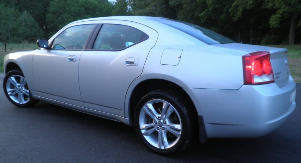

Here is a pic of Ron380's AWD Charger. You can see that the front sits a little lower than the rear just like my Maggie did.

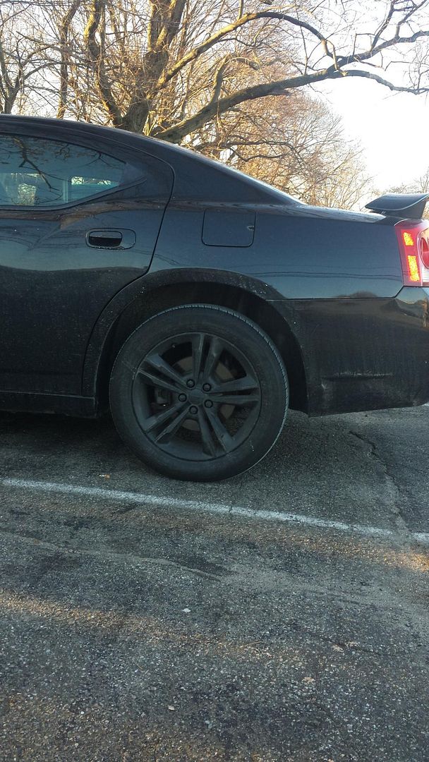

So here is a picture of my car this morning, looks a lot lower than it did yesterday. Both of these pictures are right after driving the car.... i drove more today and at faster speeds however on the highway. I think im going to hold off on calling for now. But to me the rear of the car still looks too high compared to the front and it sits almost an inch higher in the back. Any ideas?
I looks like the highway speeds produced more down force on the rear and it settled more. You should see if you can get a few big guys to sit in the rear seats while you drive around a bit and see if it settles even more. The other alternatives are to put a bunch of heavy stuff in the trunk and drive around for a week or you could also simply sit in the trunk yourself for a half an hour or so (with the lid open obviously) while it's parked in the garage.
