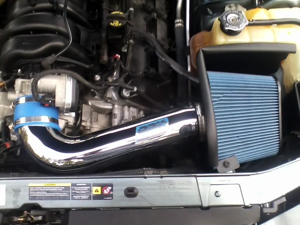

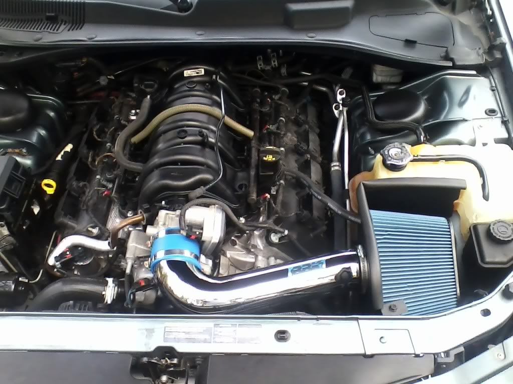

So here it is, my BBK Cold Air Induction System
the only problem i had installing it was the oil breather hose not being long enough, and the clip on the temp sensor was stubborn, but other than that it was a clean install! has a nice sound and look!:D

Congrats, looks good. That is a monster element. You can get a small breather element and connect it directly to the oil filler neck. Then get a vacuum cap to lug the port on the cai. Removes a hose and looks nice. You can find a breather element that matches your cai.
The iat connector gives everyone headaches...theres a thread 'how not to break your iat' lol.

i actually just went to the nearest autozone and grabbed about 13" of heater tubing, slid it on and it reached the filter with no problem! really gives the engine a nice growl when i get up to 3k rpm
and yes, broke the little red clip on the iat from the get go and was like damn! off to a great start! haha:clap:
