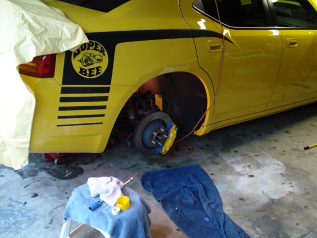

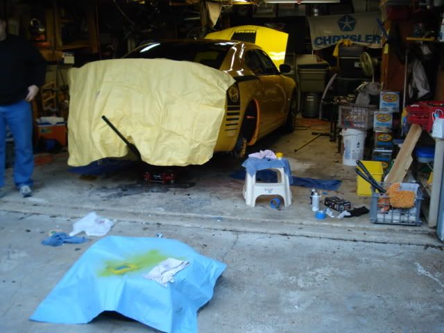

So we got to work and figured since the rear calipers are smaller, we would remove both rear tires and do both of the calipers, at the same time.
Since I had already painted the SRT letters on my wheels. John got to painting the calipers and I went to work on his wheels. That is why the back end of the Bee has a drop cloth on it. We don't need to get any over spray, on the Bee.

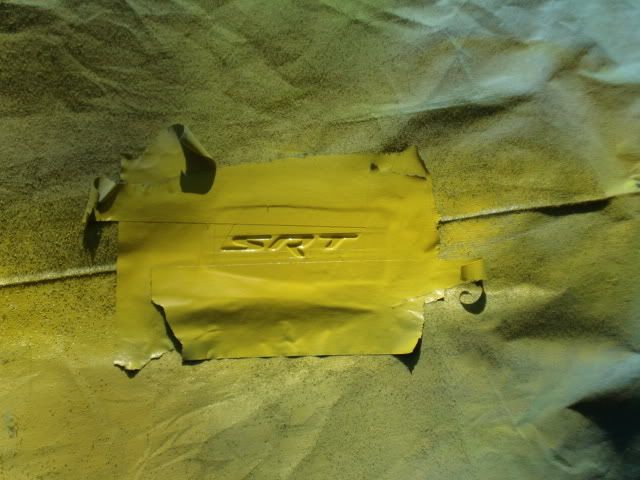

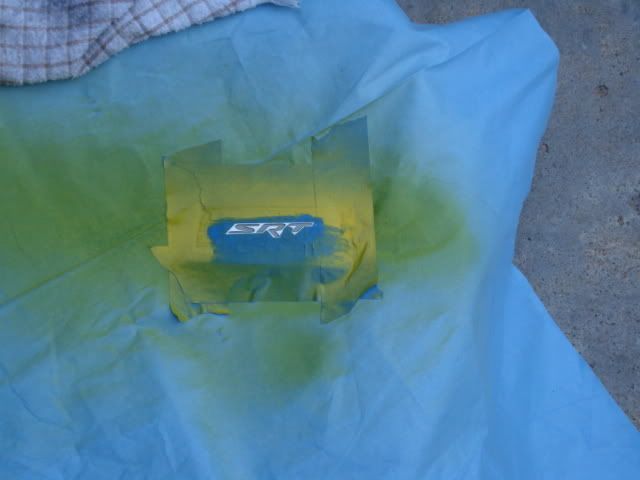

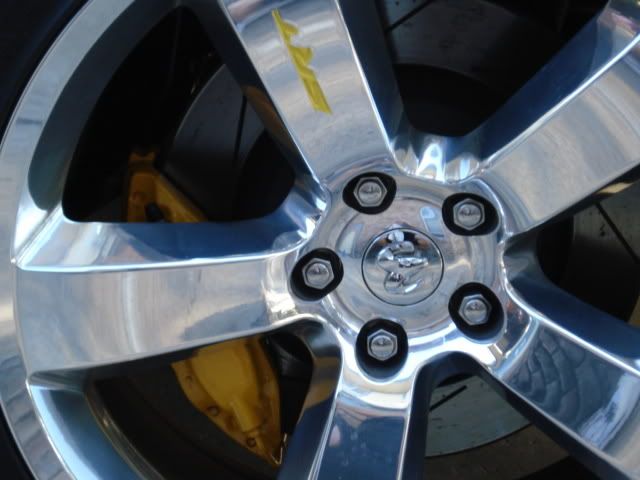

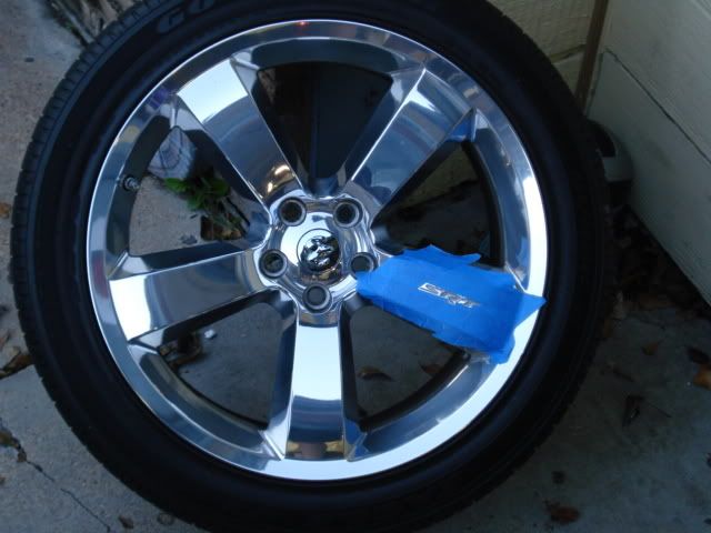

I found an easier way to paint the letters than to cut out each letter with an exacto blade. I run the tape close to the edge of each letter.

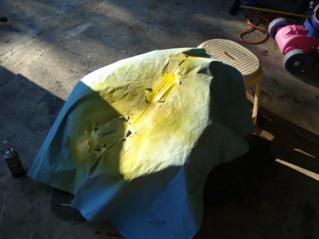

Then I take a drop cloth and cut a space big enough to go around the SRT letters. Lay the cloth over the wheel and tape the cloth to the border of the SRT letters. (protects the rest of the wheel from getting any paint on it)
Now it's ready for primer, then let it dry. Yellow paint, then let it dry. Clear coat, then let dry.
I used mother nature (SUN) to speed up the drying process, in between the various coats.

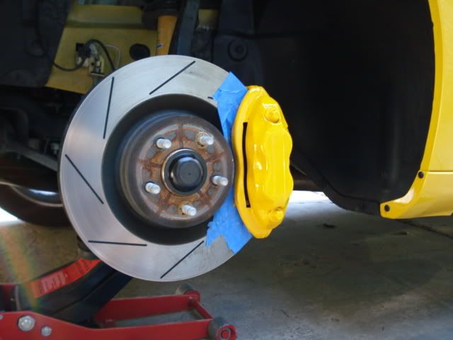

From trial and error. John found that you should use the small brush, that comes with the caliper paint kit, for tighter, smaller areas. Get a bigger, better quality brush, for the bigger areas of the calipers. John had a brush, in his garage, so no extra trip to the store.
Tape off the areas you do not want to get paint on, around the caliper.

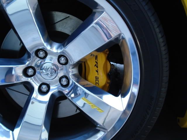

We ran out of light yesterday, see the picture of me painting above. So we put the rear wheels back on, for the night. Here you can see the rear caliper painted and the SRT letters painted, but the SRT letter edges are not cleaned up yet. I will go back with a rag and paint thinner and clean up the over spray on the letters edges.

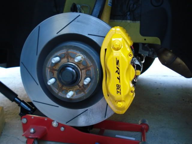

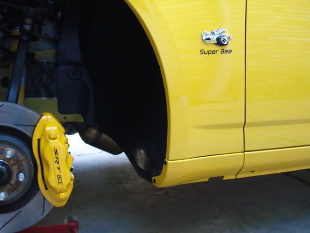

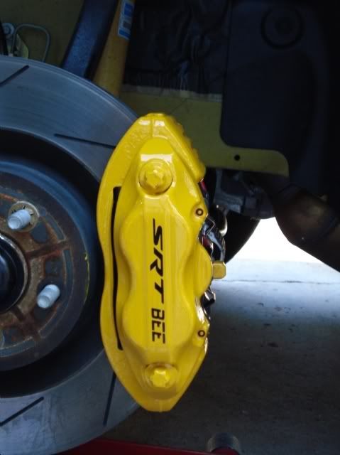

Today, John went to work on the bigger front brembo caliper. While I painted the SRT letters on the front wheel, that was removed.
When the caliper paint drys it looks like it was powder coated. Looks great.

Of the 3 designs, the SRT BEE was done with the stock SRT letters. We felt that design looked best on the caliper, since the wheel also has the stock SRT letters (going with a theme).
Some might ask. No, the entire caliper was not painted. You do not see the back side of the caliper when the wheels is on, so no need to paint it.

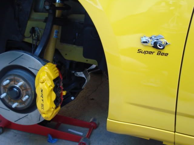

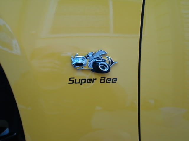

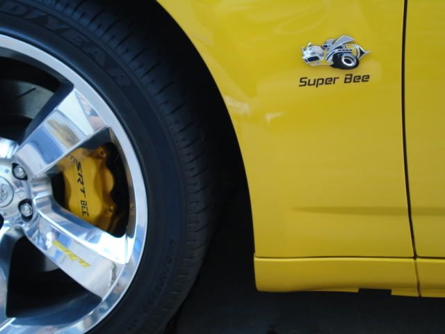

So we had extra SUPER BEE and #948 BEE design's left over. I felt the fender Bee emblems were missing something and John agreed. This turned out saweet.
Passenger fender emblem
Driver fender emblem
Caliper and fender emblem with graphics installed.

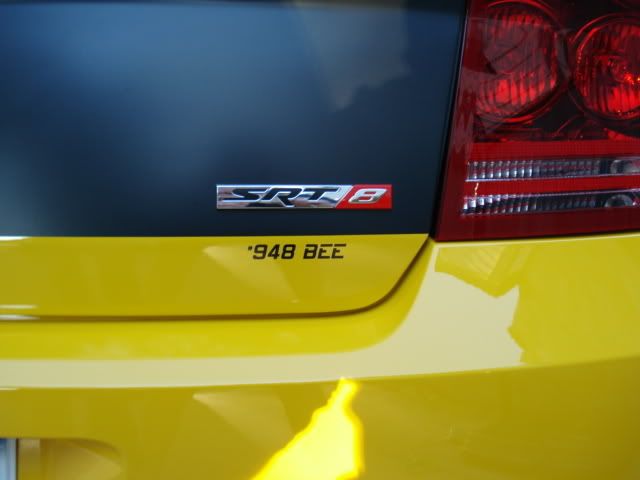

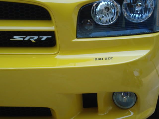

Well that left the #948 BEE graphics. We both thought this was a good place to put one of them.
The one on the trunk lid.
Front wheel/caliper all put back together again.

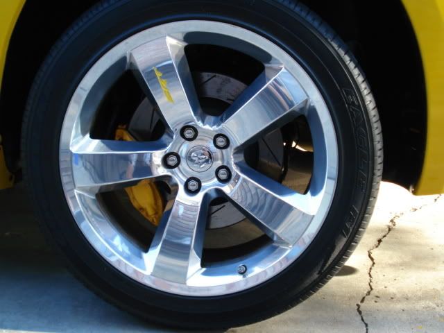

Here is the SRT letters edges, all cleaned up now.
Freebird cleaning the SRT letters.

I love the decal under Super Bee emblem. It looks perfect. It should be on every Super Bee SRTs.I felt the same way. Just the Bee alone on the fender, something was missing. The SUPER BEE nailed it.
