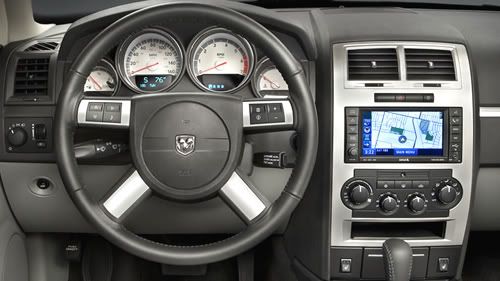

Since my accident I've been driving a 2009 300. Does anyone here know if the wiring harness is the same as the charger (power for the clock)? I want to get a 300 center bezel with the clock and put it in my RT (I love the clock,not sure why). Fit and finish look identical except the AC vents, I'm hoping the connectors for those are compatible too.
300 Dash:
2008 Charger with nav, stock(single cd) radio is the same size(I have the stock unit)
Charger Dash (this is an '06 I have an '08, the bezel is the same):
1,786 Posts
No input as far as fit, but here's a picture of the Charger dash in a 2008. The 2006 dash is way different and you can't really do a fair visual comparison for what you're asking with a pic of it.
Looks like it's possible but even one millimeter in either direction will make or break it.

I'm thinking the top edge of the 300 bezel is straight/slightly curved, whereas the charger is at an angle. That would be difficult to fix.

They look to be the same shape, except for the addition of the clock and narrower vents.
If the dashes are the same, then the bezels should be interchangeable EXCEPT for the piece that splits the air vents around the clock.
So, maybe rent a 300 for a day and take a peek inside the dash.
