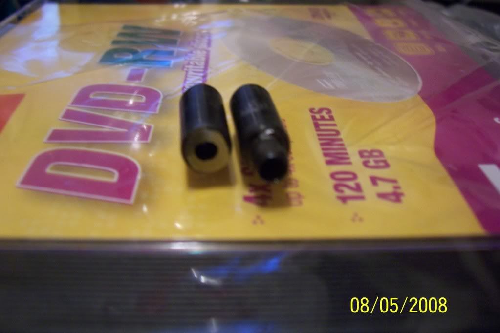

In the 3.5L engine over time there can develop a rocker arm tick. Its usually noticed when the car starts up. For some it may go away after a few minutes of driving. over time however, it will last longer and longer and sometimes may come back while driving here and there. The tick is caused by a rocker dowel pin SHEARING, yes shearing off.
(photo credit:Tbird100636 via LX Forums)

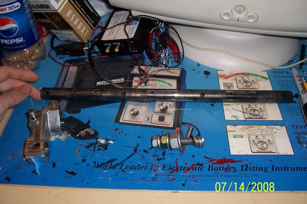

when this occurs the dowel that the rocker arms are located on tend to shift when in use. From the shifting the oiling holes become misaligned and the rockers starve from oil a bit.
you can disassemble and reassemble your current setup, or you can simply buy a whole new setup. when i recently did mine, i just bought the new one as i already have 164K miles.
In most cases after shaft removal, you can see where the wear and movement occured
(photo credit: Chickenstrip via LX Forums)
if you chose to rebuild yourself, here are the part numbers (credit Tbird100636 via LX Forums)
